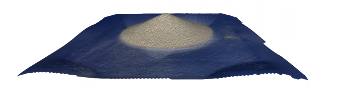

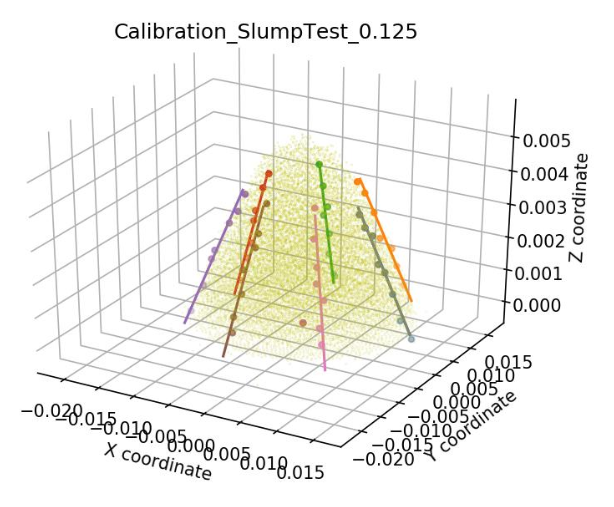

The static slump test was chosen as the calibration experiment used to investigate the particle-particle interactions. The static slump test involves pouring powder into a vertical hollow cylinder, allowing the powder to come to rest and then lifting the cylinder. The coefficient of sliding friction can then be calculated by measuring the angle the slumped powder pile makes with the horizontal, known as the Angle of Repose (AoR). AoR is related to μs by the following equation which can be derived from the free body diagram of an object sliding down a slope [2]:
μs = tan(AoR)
The angle of repose was measured manually using a digital protractor. These measurements were then further validated by using Standard Cyborg’s Capture App to create an IR point-cloud scan of the powder pile. The AoR of the scanned model was then measured using a Python script and the results were within 1 degree of the manual measurements.
![](https://altair.com/images/default-source/news-images/afrc-standard-cyborg-capture.png?sfvrsn=9ceb5e52_10)
This test was chosen for 2 main reasons: the physical experiment is simple and low-cost, and the numerical experiment already exists as part of EDEM’s Calibration Kit. The Calibration Kit is integrated with EDEMpy to measure the AoR directly from the EDEM workbench model, greatly improving the accuracy and convenience of the numerical experiment.

The μr is more difficult to determine experimentally. Instead, once both values of μs had been calculated the value of μr was incrementally changed until the AoRs from the EDEM simulations matched those from the physical experiments. This calibration procedure could be repeated for a range of different materials and powders, provided that new physical experiments were carried out.

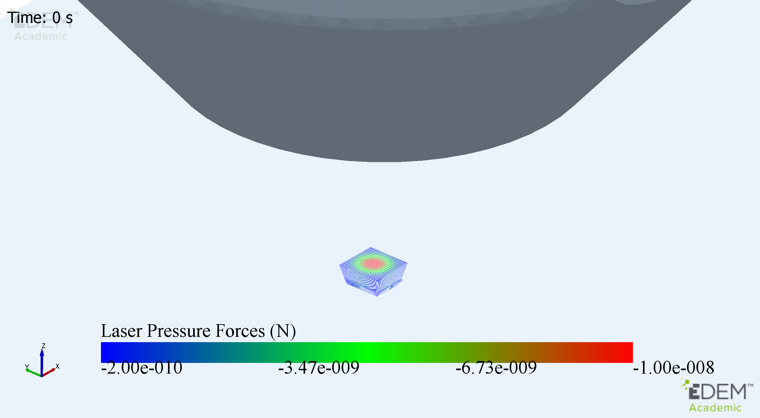

To make the EDEM model more representative of the gas-particle interaction within the nozzle, it was necessary to include Particle Body Forces that act upon the material. The two that were analyzed were the pressure forces from the laser and the aerodynamic forces from the various gas flows introduced by the nozzle. To implement these forces, a custom plugin was created using the Application Programming Interface (API) provided by EDEM.
This was comprised of different interfaces that provided the necessary methods and structure to add these forces during each calculation iteration. The code created was a single class that was derived from the “ParticlePluginForcesV3_1_0.h” interface that was provided as part of the API. Using this interface, and some other tools also provided in the API, the codes that could implement the forces from the laser were generated. This was done by adding the components of the force in each discrete region to a particle if it happened to be in the laser beam area. The particles were treated as a point mass located directly at their centre and thus this position was used to determine which laser forces to apply.
This simplified the problem, as in reality the particles were significantly larger (x5) than the discrete laser force regions. This meant that each particle would experience different forces over its surface when in the laser beam. This could have been solved by a surface integration scheme; however, this would have significantly increased the complexity and it was decided this was out with the scope of the project. A linear interpolation scheme between the particles and their nearest neighbouring forces was instead used, as one already existed in the API.
