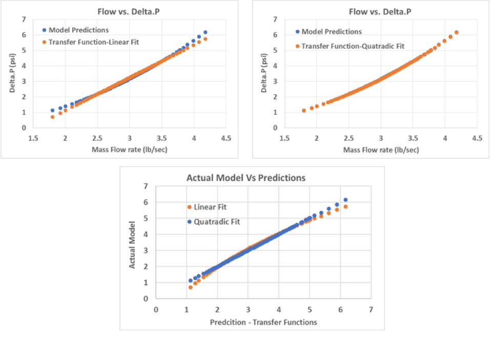

In the simple example shown in Figure 6, our aim is to study the effect of flow rates variation on the pressure drop across the orifice. All the detailed steps involved in design of experiments (DOE) generation are illustrated in the figure. Once the DOE’s are created and Flow Simulator completes the runs, the user can create transfer functions and analyze them. Figure 7 shows the comparison of the results between the actual model predictions and the results of the transfer functions, which for this simple model are almost identical.

Figure 7: Comparison of results of actual model and transfer functions
