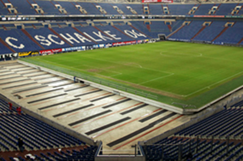

The Veltins-Arena in Gelsenkirchen, Germany, is famous for outstanding soccer games. To enable a superb soccer game, the field must be in top condition. The arena planners have guaranteed this with a fabulous technical trick: when no games are scheduled, the entire grass field is moved outside the stadium. The complete playing field with a total weight of 11.400 t can be moved in and out of the stadium over a distance of 300m in four hours. This allows the grass playing surface to grow outside under normal conditions and it does not get damaged during indoor events such as concerts.
How Does a Playing Field Move?
The soccer field is pushed or pulled over 16 slideways with a Teflon coating. The motion is supported by several hydraulic modules including pumps, reservoirs, valves and cylinders that move in position control with a master-slave-structure. The whole move is done step by step, alternating a push/pull stroke with a retracting stroke. The challenge for the hydraulics and control is to get very even and steady movement of all cylinder drives independent of supply pressure, friction and other disturbances.

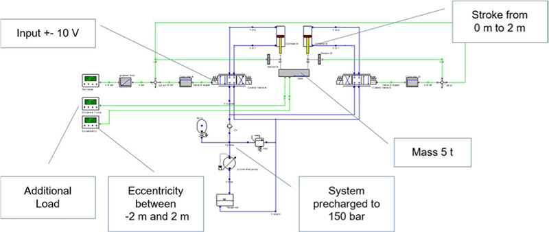

Modeling the Hydraulics Actuator Systems with DSHplus
Hydraulic-mechanical systems can be built up in DSHplus to describe real systems. For this application, a hydraulic system with excitation of actuators was created. Afterwards, the model can be used for troubleshooting, system optimization or co-simulation with, or embedded export to, other programs such as solidThinking Activate. For export, the model is prepared with inputs for valve signals, external load and eccentricity as well as outputs for cylinder strokes. The data is transferred via FMI (Functional Mock-up Interface) and the hydraulic model is exported as FMU (Functional Mock-up Unit). The FMU file includes the hydraulic-mechatronic model, solver, parameters and descriptions.

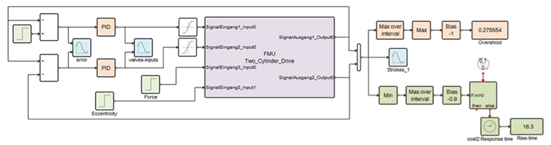

Modeling the Control System with solidThinking Activate
The hydraulics model exported by DSHplus is from now on seen as a black box, simulated within solidThinking Activate.
The connections to the hydraulic model must be set correctly to optimize the control in Activate. In the various control components, a controller can be found to reject disturbances and react fast enough to input changes. After first parameterization of the model, few steps for optimization are needed to gain optimized results.
