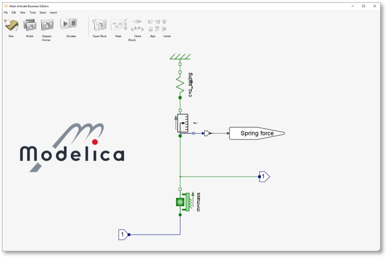

Mechanics
Within Activate®, Modelica Standard Library (MSL) is used to model the mechanics of the mass of the valve’s plunger and spring. Magnetic force, pressure forces, and flow forces can be calculated in their own domain model and added to the connections.
