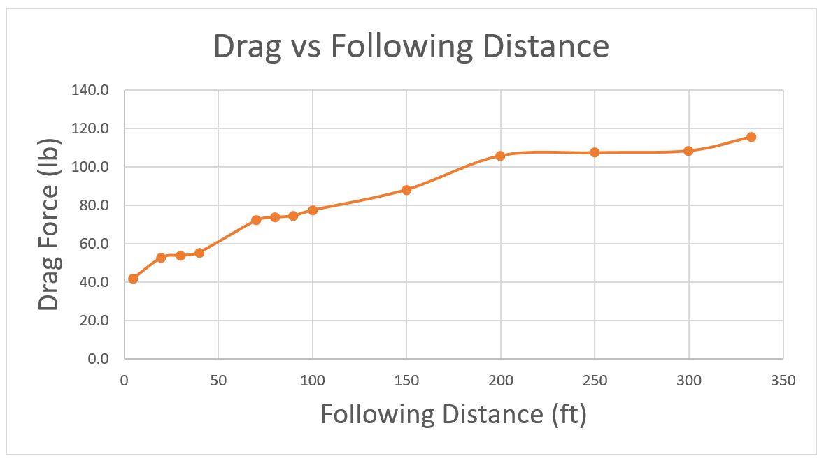

By evaluating several distances between 5ft and 333 ft, the following graph of the drag force vs distance was created. This graph clearly shows the effect of the following distance on the drag force, but also the fact it is not a linear phenomenon.

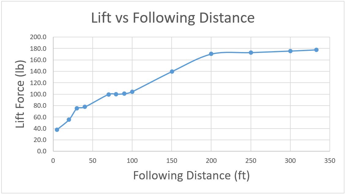

Most passenger vehicles on the road today produce lift at highway speeds. Lift is the same force that allows airplanes to fly. In a car, a large amount of lift may make the car feel unstable because it actually unloads the tires which make contact with the road.
The graph below shows the lift force vs following distance, and it shows a similar trend as the drag force.
Altair’s Virtual Wind Tunnel allowed a determination of the drag and lift forces, and by doing a parameter study, we were able to confirm our initial assumptions. Both drag and lift can be reduced by decreasing the following distance behind a truck.  However, to get any noticeable reduction in energy expenditure, you would have to follow at an unsafe distance for a human driver’s reaction time. To gain any benefits in fuel economy, you would be putting yourself in danger of a collision if the truck came to a sudden stop. This theory is validated, but please don’t try this at home!
